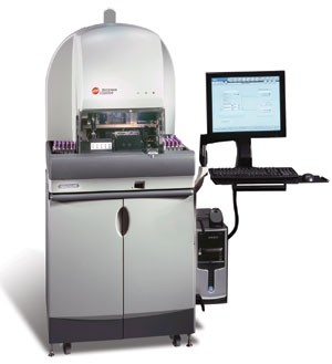

Today’s hematology laboratories are challenged by ever-increasing pressure to improve productivity, decrease turnaround time and reduce overall costs. The UniCel DxH platform is designed to meet these challenges head-on and transform your laboratory, with unparalleled quality of results, innovative efficiency solutions and revolutionary scalability. Heralding a new era of hematology solutions, the UniCel DxH 800 delivers the ultimate in high-definition cellular analysis. This is just the beginning of the transformation journey. Partner with us to see what the future holds.
UniCel DxH 800 Coulter
Attributes
Height 38 in
Length 31 in
Weight 260 lbs
Width 30 in
Additional Specifications Throughput
Up to 100 samples/hr
Aspiration Volumes
Open/Closed Vial 165 µL
Power
90–264 VAC and 48–62 HZ
DxH 800 System with System Manager and printer draws 1,185 watts
DxH 800 System with System Manager, printer and UPS draws 2,390 watts
Data Management
Computer Microsoft* Windows* XP
Database 40,000 Patient results with Graphics
Quality Assurance QC with Levy-Jennings Graph, XB/XM for Moving
Averages, Daily Check, Intelligent Quality Monitoring
Sample Transport Capabilities
Capacity 20 five-tube cassettes
Bar Codes Digital Bar Code with 2D Bar Code capability
Sample ID Up to 22 characters
Features
  • Single aspiration pathway simplifies calibration and quality control process while eliminating mode-to-mode issues
  • Sample Aspiration Module (SAM), with its unique design, reduces aspiration volume, especially benefiting pediatric samples
  • 2D-Digital Bar Code Technology maximizes reading capability, preventing errors and reducing misreads
  • Remote Management System (RMS) increases versatility by proactively performing diagnostics with real-time troubleshooting, leading to increased instrument uptime
  • Specimen Transport Module (STM) uses a unique, patented magnetic system for continuous loading of up to 20 cassettes, allowing “load 'n' go” capability
  • Intelligent workload distribution optimizes workflow by achieving rapid turnaround times, providing STAT and ER results quickly
  • Provides automation in a small footprint
  • On-board tracking, for optimal reagent management
  • With its future upgradability the UniCel DxH 800 can be converted to a full laboratory workcell, providing tomorrow’s platform today
  • High Definition Cellular Analysis on the UniCel DxH 800 provides four times greater resolution and achieves new levels of performance
  • Flow Cytometric Digital Morphology (FCDM) optimizes performance by providing 10 times more data per sample than existing technologies, allowing reduced review rates
  • With its multi-angle scatter technology, onboard reagents and new advanced algorithms, the UniCel DxH 800 provides an unrivaled NRBC, with no need for special or expensive stains
  • Using its data fusion capability, the system will correct for most of the common interferences in today’s laboratory, ensuring first-pass accuracy and efficiency
