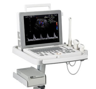

SonoAce R3
The Medison SonoAce R3 portable is an easy to use, EMR-compatible ultrasound system that provides one-touch image optimization & great connectivity at a fantastic value.
