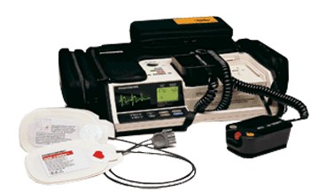

Lifepak 10
The Medtronic Physio-Control LIFEPAK 10 defibrillator/ monitor/pacemaker was designed to withstand the harsh environment faced by emergency medical providers throughout the world. This rugged, portable unit, which follows the tradition of the company's LIFEPAK 5 defibrillator/monitor, is built tough to withstand demanding field requirements.
Lifepak 10
Attributes
Defibrillator Type External, Automated (AED)
Weight 20 lbs
  • Battery:  3 NiCad batteries, 12V, 1.0 amp hours each.  A new Battery Pack registering at least 100% capacity on the Battery Support System will provide at a minimum: 45 minutes of monitoring or 30 minutes of pacing or 25 discharges at 360 joules per Battery Pack
  • ECG Lead Selection:  Paddles, I, II, III
  • Input:  Isolated ECG via quick-Look defibrillator paddlews, Fast Patch electrodes, or 3-lead patient cable.
  • Cardioscope Display Size:  72.55 mm (2.85 in)  x 43.5 mm (1.7 in), non-fade.
  • Defibrillator Waveform:  5 msec monophasic pulse (Edmark) per AAMI spec.
  • Energy Select:  0, 5, 10, 20, 50, 100, 200, 300, 360 joules.
  • Paddle Controls:  Charge (with indicator light); Record (activates strip chart recorder); Energy Select (rotating dial 0-360j); Discharge (dual energy discharge buttons, on on each paddle).
  • Charge Time:  Charges to 360 joules in less than 12 seconds above 0°c.
  • Paddle Area:  82 cm2
  • Synchronizer:  Delivers energy discharge within 20msec of sync marker on cardioscope.
Features
  • Primarily used in Ambulances and Emergency Rooms
  • Lightweight, portable defibrillator monitor
  • Built-in Recorder
  • Battery operated, AC adapter optional
  • Requires seperate battery charging system
  • Meets current ACLS standards
  • Easy-to-read display
