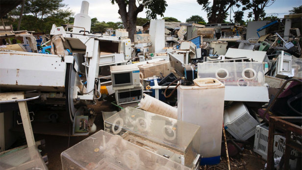

On a recent visit to a regional hospital in sub-Saharan Africa, I found myself in an operating room with 12 abandoned anesthesia machines — more unused devices than the hospital has surgical staff.

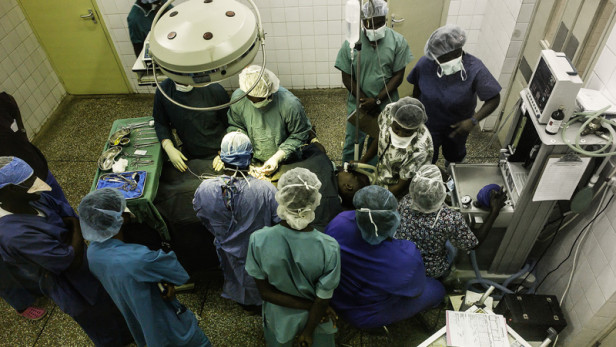

It’s no surprise that this hospital lacks the capacity for general anesthesia, rendering safe surgery inaccessible for the hundreds of thousands of people it serves. Other equipment needed for even minor surgery fares no better: broken theater lights, unreliable suction devices, damaged vital signs monitors and sadly antiquated machines. The failures engulf the entire surgical suite. Unfortunately, this scene is more common than not in low-resource hospitals.
Surgery requires a complex physical environment to be in place before the first patient can be treated. Medical devices are often donated and frequently useless, which is why roughly half of them are unusable in developing countries.
Equipment “graveyards” like the one I witnessed are depressingly commonplace. Infrastructure and device failure often leads to postponed or interrupted operations and referrals to other, sometimes distant hospitals. In emergency cases, the results can be catastrophic.
