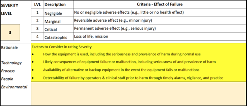

  • Severity Level - Define and score the severity of failure.  In Figure 1, there is an example of the factors, score definitions, and rationale

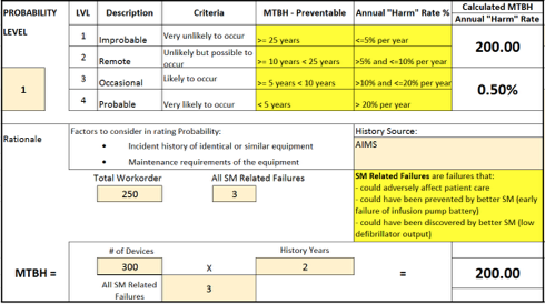

  • Probability Level - Define and score the probability of failure.  In Figure 2, there is an example of the factors, score definitions, and rationale
  • Mean Time Between Harm (MTBH) = (# of devices X years of history) / All scheduled maintenance related failures
  • Annual Harm Rate = MTBH/1 as expressed as a %

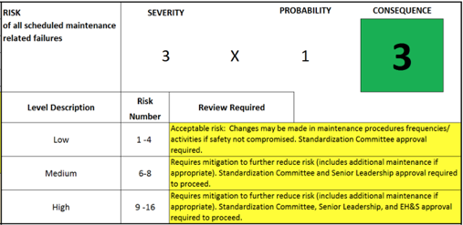

  • Risk – The resulting scores from severity and probability are multiplied to establish an overall risk score.  Definitions and review approval are defined in Figure 3.
  • Criteria for adoption starts with escalation of approval levels as appropriate for your organization.  I believe that you should highly consider Low risk items and be very cautious on adopting Medium and High-risk equipment.
