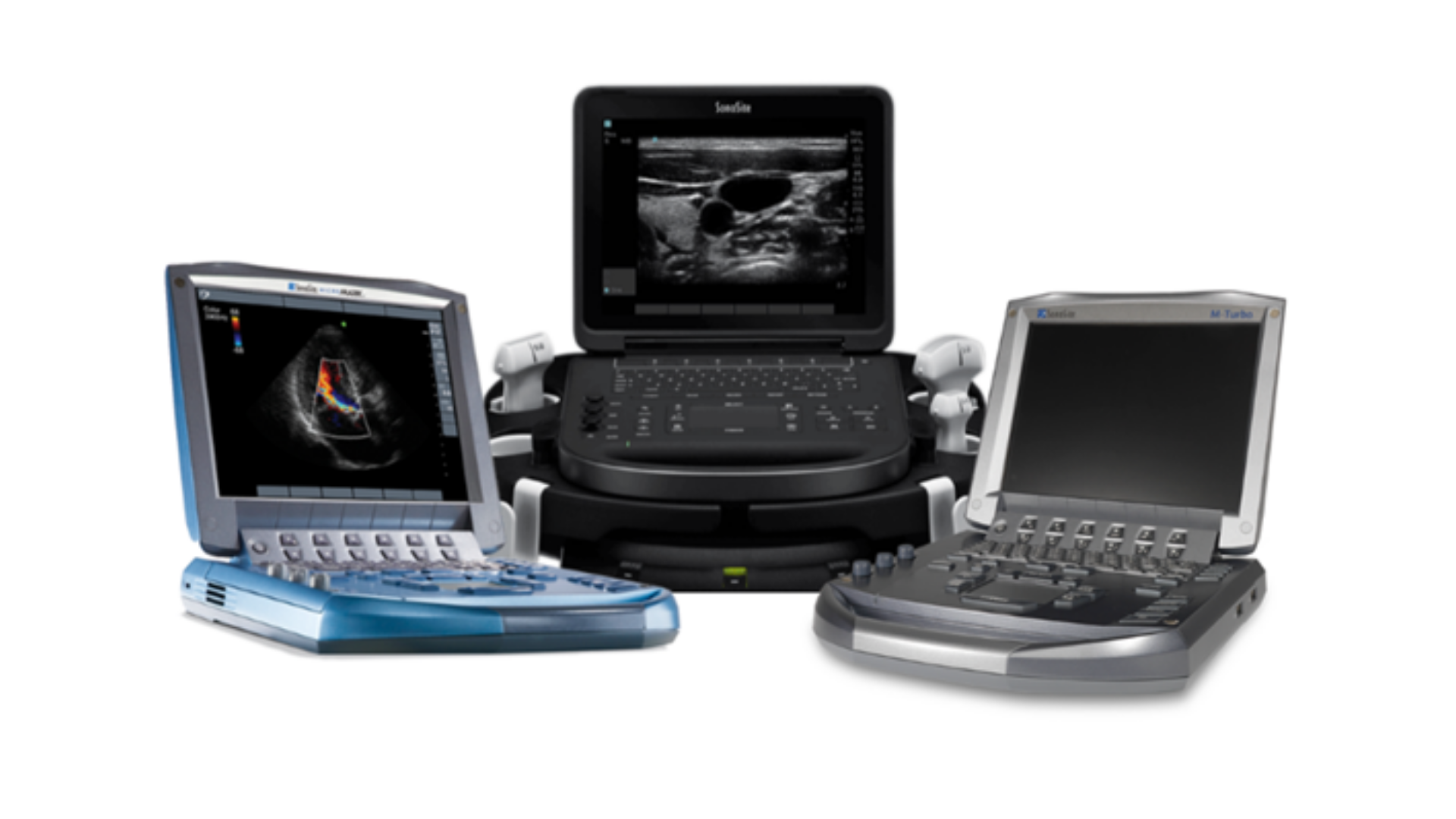

What makes Sonosite’s Portable Ultrasound Systems unique in the portable diagnostic ultrasound systems market?
In the growing market for portable diagnostic ultrasound, Fujifilm Sonosite’s offerings are quite different from most other portable systems. They have a highly integrated design which allows for units that are smaller, lighter and much more durable than most other portable ultrasound systems. They also have fewer requirements for maintenance.
A quick YouTube search for “Sonosite Drop Test” will yield several videos of Sonosite portable systems being dropped from a height of 3 feet onto a concrete floor to demonstrate their durability. While I don’t recommend repeating this test with your own system, it certainly is an impressive feat that demonstrates why the designers had to take a very different approach to creating these systems.
One of the biggest differences is Sonosite’s approach to designing the system’s core electronics. With all of the acquisition front-end functions and back-end image processing functions implemented on a single PCB, it is one of the most unique and highly integrated ultrasound systems out there.
