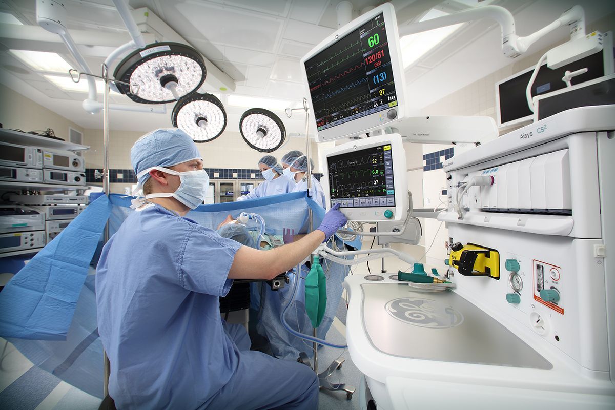

A critical part of the operating room, the anesthesia machine helps keep patients unconscious and breathing during surgery. In alignment with recently issued guidance from the U.S. Food & Drug Administration (FDA), GE Healthcare has provided information to customers on the use of anesthesia machines for patients needing mechanical ventilation during the COVID-19 pandemic.

A critical part of the operating room, the anesthesia machine helps keep patients unconscious and breathing during surgery. In alignment with recently issued guidance from the U.S. Food & Drug Administration (FDA), GE Healthcare has provided information to customers on the use of anesthesia machines for patients needing mechanical ventilation during the COVID-19 pandemic. Top and above images credit: GE Healthcare.
