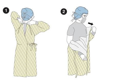

References:
  1. Association of Operating Room Nurses (2014), Standards and Recommended Practices. Denver: AORN.
  2. Appendix A: Proper doffing of Personal Protective Equipment
