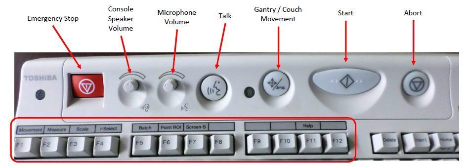

From the console, turn on the power switch.
Allow the system to boot fully. If this is the first use of the scanner for the day, the scanner will automatically initiate a tube warm-up. Begin a tube warm-up by pressing the Start button on the Scan console and allow it to complete.

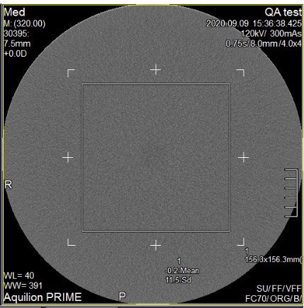

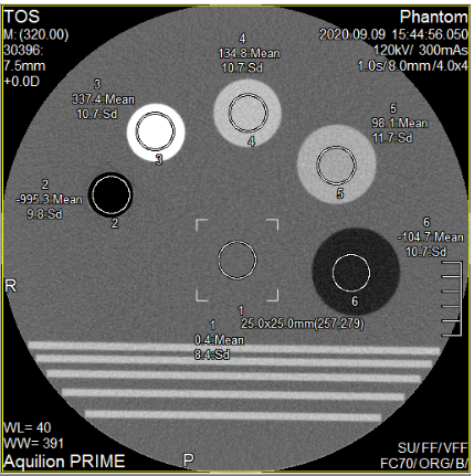

Perform any QA scans that are required by the facility and/or site physicist. The QA scans can be useful in checking for artifacts and any shift in CT numbers, indicating a possible problem with the scanner. Shown below is an example of a QA scan completed for a medium water phantom.
This image shows a typical QA scan using the TOS phantom supplied with each scanner.

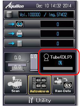

A tube warm-up should be done before a clinical scan when the tube OLP has dropped below 20%. Doing a tube warm-up before the clinical scan will prepare the tube for a potentially higher kV/mA exposure used during a clinical scan. These exposures should not be made on a cool tube, whenever possible. In the latest release software, you initiate a warm-up by clicking on the Tube(OLP) window on the main screen.
