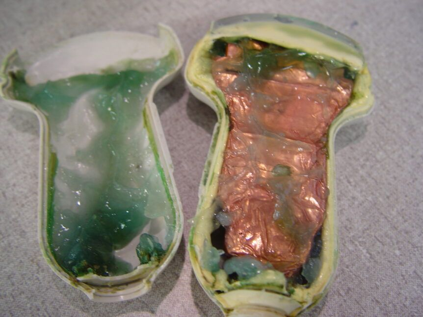

You may be surprised to learn that many of the probes evaluated at our Ultrasound Center of Excellence have failed as a result of preventable damage. A significant portion of those probes have experienced failures as a result of indirect chemical or fluid intrusion at the scan head. Most would agree that no one would ever purposely expose an ultrasound probe to damaging chemicals or somehow allow fluid to gain access to delicate electronics. This post addresses the importance of periodic visual inspections of ultrasound probes.
The truth is, items, such as seams, seals, acoustic lenses, and strain reliefs will experience wear and will degrade as a natural result of repeated exposure to chemicals such as gels, cleaners, and disinfectants. Even OEM approved chemicals have the potential to have long-term affects to these components. Using a chemical which is not approved by the OEM or using an OEM approved chemical improperly can result in highly varied long-term effects and may even result in some in the short-term.
Example
The seams, that join the various sections of a probe housing will, over time, begin to separate leaving very slight openings. The seals surrounding the acoustic lens will eventually deteriorate resulting in potential points of entry for foreign substances. Once a seam or seal has been compromised, chances are that every time the probe is subsequently wiped down or exposed to some type of liquid or gel, some of that chemical will find its way inside of the probe.
Fluid entry can lead to a multitude of problems, some being hard failures and others resulting in performance degradation over time. When it comes to ultrasound probes, it’s hard to find an OEM that does not recommended that end-users, specifically sonographers, visually inspect each probe prior to each use. That being said, OEM’s differ on their messaging, where that messaging is located, exactly what should be inspected, and what defines good versus bad. It’s also up for interpretation as to, just how bad is bad and what are the repercussions of using a probe with, what may appear to be, only minor cosmetic issues.
There really is extremely strong value in performing frequent visual inspections. From a cost perspective, resealing a lens or a probe housing may only cost a few hundred dollars. Contrast that to having to repair complex electronics, replacing the acoustic array or even the entire probe at a cost of thousands. Although over 200 years old, Ben Franklin’s quote still proves true in today’s digital world. “An ounce of prevention is better than a pound of cure”.
