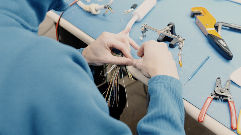

Cables still wear out. How does Innovatus deal with worn and damaged cables and wiring?
Our goal is to recover and re-use as much of the customer’s original device as possible. If need arises, Innovatus can provide full cable repair / replacement solutions which perform as the OEM intended. From engineers, to sourcing specialists, and wiring techs, we have teams in each facility dedicated to cable repair. Model dependent, device lifecycles are no longer limited to the lifespan of or variables which affect cable performance. Innovatus can restore cable performance and put the device lifecycle back on track. Full cable repair and replacement solutions are available on over 100 ultrasound probe and over 800 MRI coil models.
