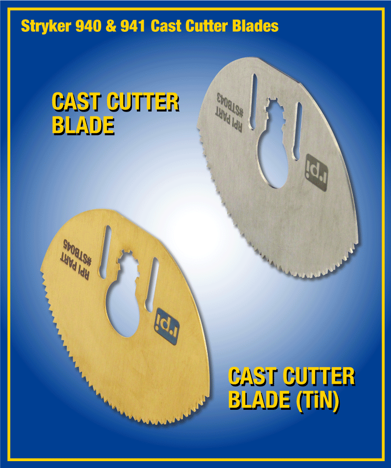

I understand that Stryker is no longer selling cast saws and blades – does RPI have plans to continue part support for both the older 800 series cast and autopsy saws as well as the newer 940 cast saws?
Yes! Not only will we continue selling our parts for these discontinued models, we have expanded our offerings by manufacturing blades for the 940 cast saws. Sold in several different versions, the RPI cast saw blades are long-lasting direct replacements for the Stryker 940 blades. RPI has also recently started selling parts for the model 986 cast vacuum and plans are in place to add additional repair parts for the cast vacuum systems.

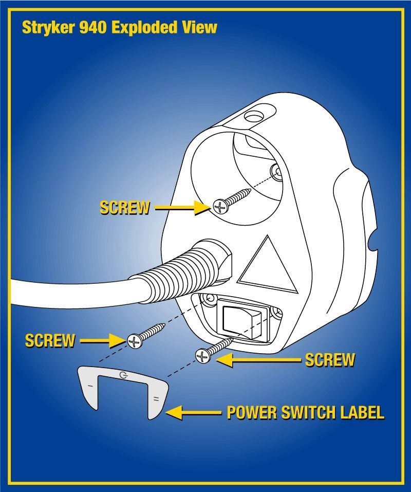

I want to clean the armature of my 940 cast saw but I can’t seem to get the case open. Any suggestions?
The case on the Stryker 940 cast saw is held in place by 3 screws, only one is exposed. The remaining 2 screws are located behind the decal surrounding the power switch. You will also need to remove the brush caps and the brushes before you can remove the rear section of the case.

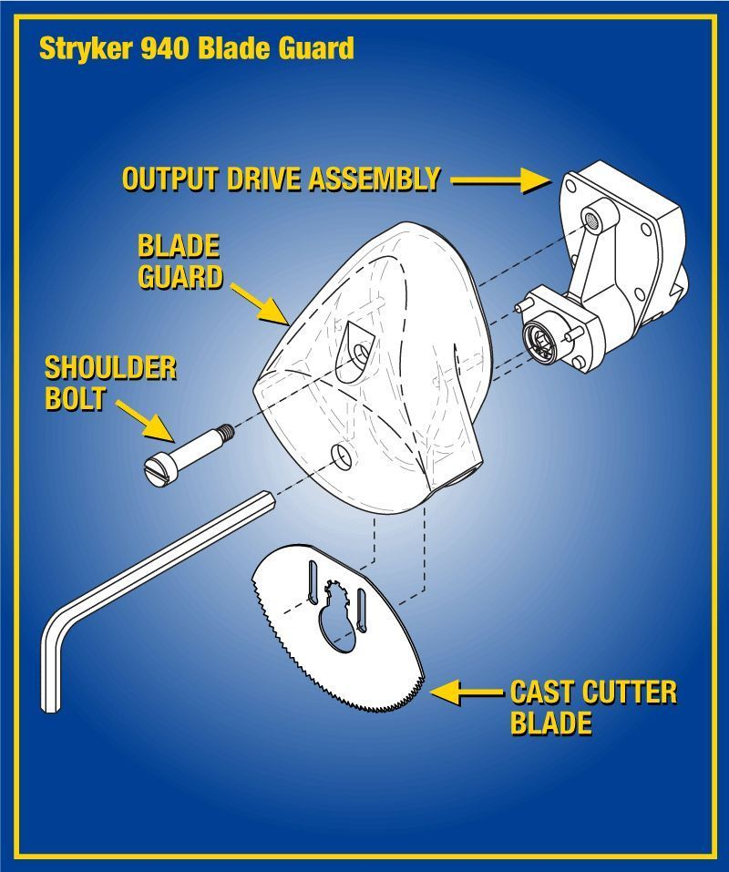

I’m having problems with the blade guard on the model 940 cast saw – I’m having a hard time removing the shoulder bolt and rethreading it in after I replace the blade and clean the head.
Cast saws generate lots of dust and no matter how well the vacuum systems work, there will always be dust working its way into those threads. One solution you can try is a little bit of penetrating oil on the threads to help flush the dust out. However, if the threads are damaged, replacing the output drive assembly is an easy single part fix.
