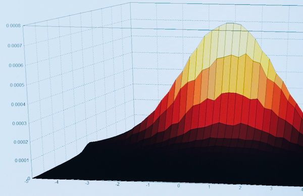

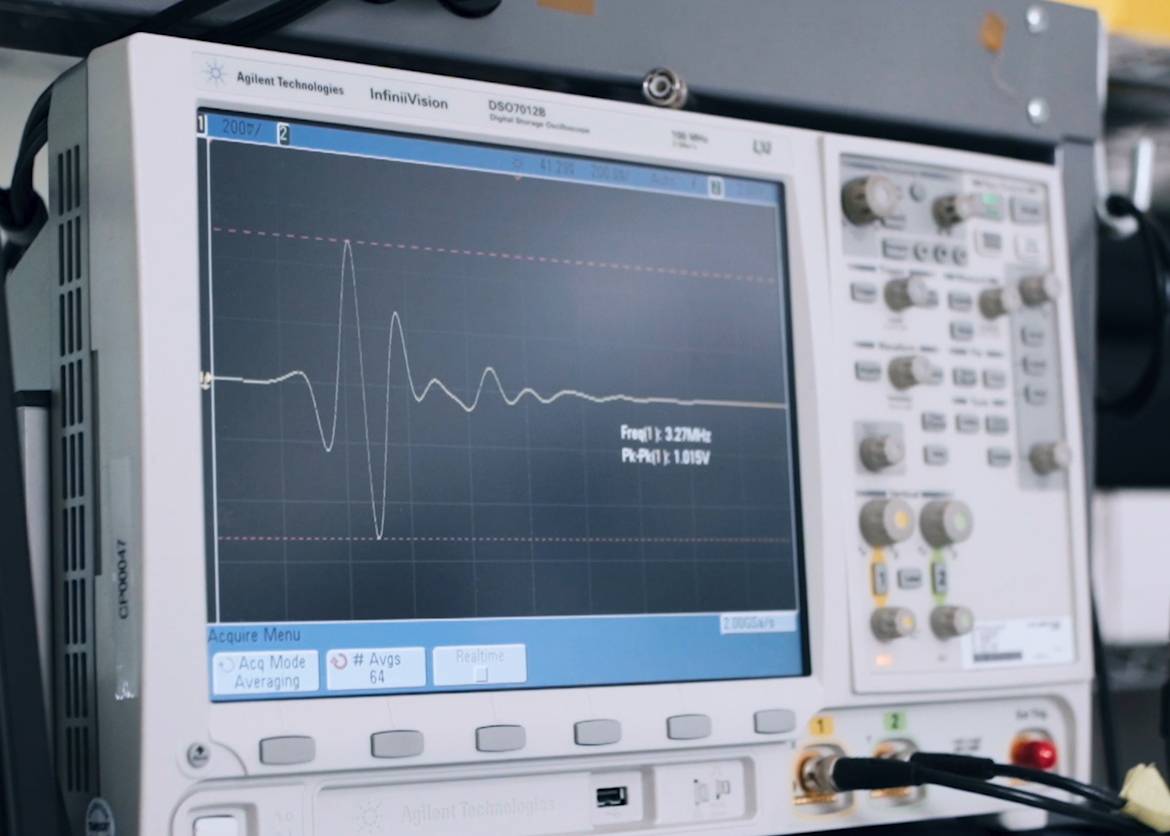

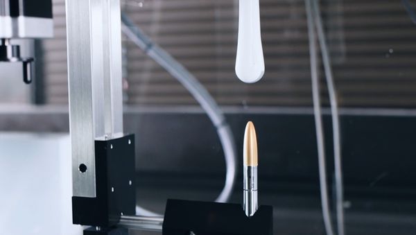

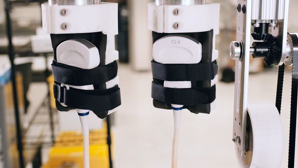

We have a multitude of devices and processes to qualify the safety and performance of ultrasound devices. Devices, such as a hydrophone and a radiation force balance, are used to quantify a probe’s acoustic output. These provide 3D mapping and measurement of the acoustic pressure field being emitted from a probe. A pulse-echo test, as seen in the header photo, enables us to visualize and measure the acoustic pulses from each individual element within an ultrasound array. This device twists and turns cables, wiring harnesses, and strain reliefs hundreds of thousands of times to benchmark and qualify performance and longevity. We also measure and document the face temperature of ultrasound probes to confirm that it remains in compliance with federal regulations and international standards.
Hydrophone Testing Tank
Acoustic Output Graph
Cable Stress Testing
