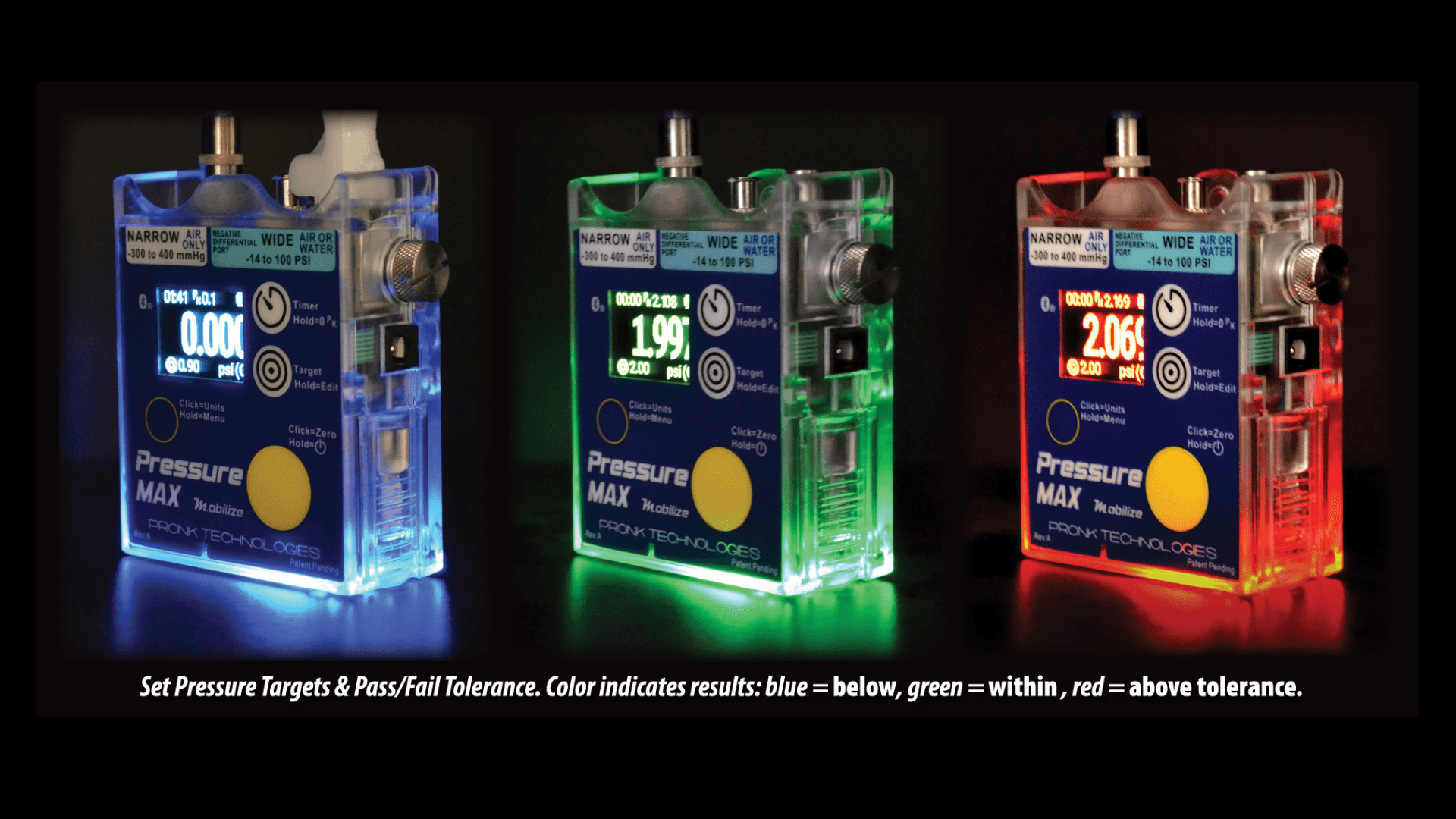

The smallest biomedical digital pressure meter on the market is now available from Pronk Technologies. At half the size and with up to two times the accuracy (narrow port) of other pressure meters, the Pressure MAX is designed to test virtually any type of medical device. It features:
  • Pressure Testing of Fluid, Gas or Air (2 independent channels)
  • Narrow Port range of -300 to 400 mmHg, capable of accuracy to 0.2% of reading for positive pressures, 1% for negative pressures
  • Wide Port range of -14 to 100 PSI, capable of accuracy to 1% of reading.
  • Details:
    • Thumb Screw Exhaust Port: expels air bubbles during fluid testing
    • Automatically captures peak pressure
    • Digital Timer: start-stop integrated timer for leak / inflation rates
    • User-selectable 11 units of measure to meet any application: mmHg, PSI, inH2O, cmH2O, kPa, atm, inHg, bar(a), bar(g), mbar(a), mbar(g)
  • Pronk Mobilize™ wireless technology: captures data electronically
  • Runs on 2 AA batteries
  • 4-year warranty, 50X-drop-test rugged
