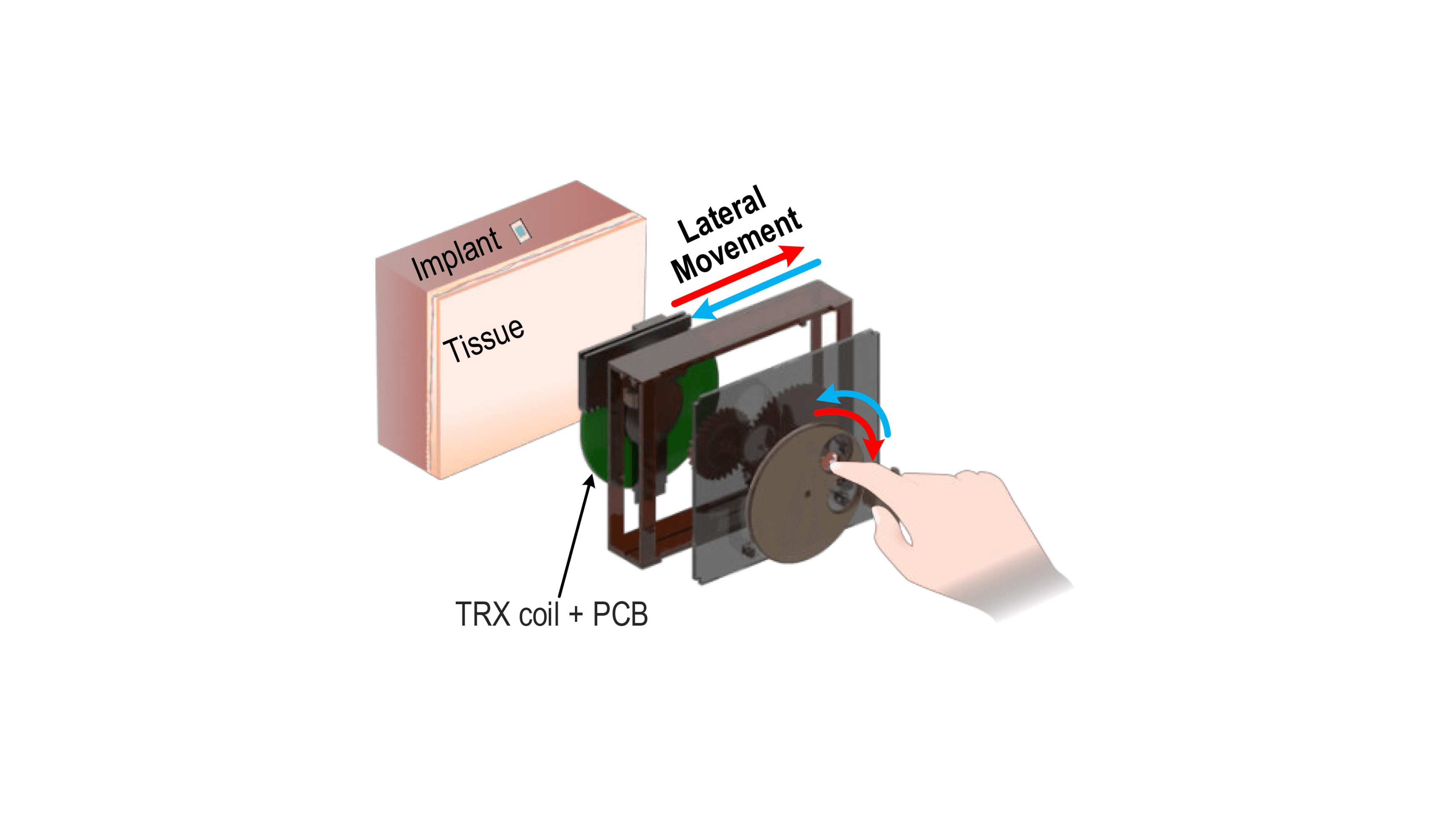

In recent work presented at the International Solid-State Circuits Conference (ISSCC) the flagship conference of the Institute of Electrical and Electronics Engineers (IEEE) Yang and his team unveiled a first-of-its-kind authentication protocol for wireless, battery-free, ultraminiaturized implants that ensures these devices remain protected while still allowing emergency access. Known as magnetoelectric datagram transport layer security, or ME-DTLS, the protocol exploits a quirk of wireless power transfer, a technology that allows medical implants to be powered externally without a battery. Normally when the external power source or in this case the external hub worn by the patient moves slightly out of alignment, the amount of power the implant receives fluctuates.
“Lateral or side-to-side movement causes a signal misalignment that is usually considered a flaw in these systems, but we turned it into a security feature by transmitting binary values to specific movements with full awareness of the patient,” Yang said.
For example, by coding short movements as a “1” and longer movements as a “0,” the protocol enables users to input a secure access pattern just by moving the external hub in a specific way. This pattern-based input acts like a second authentication factor, much like entering a PIN after using a password or drawing a pattern to unlock a phone. The overall user experience with the ME-DTLS two-factor authentication closely resembles the process of logging into bank accounts today. Users enter their login credentials, wait for an SMS with a temporary passcode then input this passcode to log in.
This innovation solves two major problems in medical cybersecurity. First, it protects against stolen passwords by requiring a physical confirmation step that cannot be faked remotely. Second, it ensures emergency responders can access the device without needing preshared credentials. Thus, if a patient is unconscious or unable to provide a password, the implant transmits a temporary authentication signal that can only be detected at close range.
“This ensures that only a nearby authorized device can access the implant,” Yang said. “In emergencies, the implant verifies the responder or doctor by the pattern they draw and gives them access even if there is no Internet connection.”
