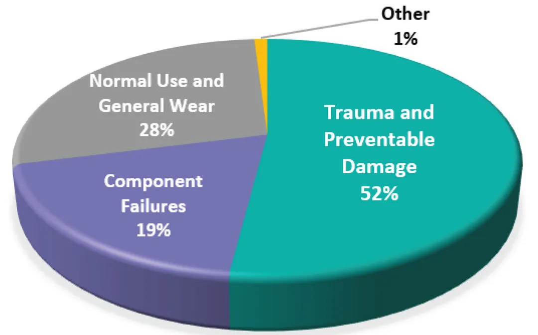

Coil lifecycles can be affected by several factors: Random electronic failures, general wear, premature wear, and preventable damage/trauma. Based on data captured in the past 2-years, spanning over 5,000 coil repairs, over 34% of all MRI coils present with mechanical damage due to preventable damage or trauma. An additional 18% possess failures RELATED to preventable damage/trauma (totaling about 52%). About 28% are related to general wear and less than 20% are actually failing due to random electronic component failures.
Simply stated, the majority of MRI coils sent to Innovatus have a root cause associated with physical, mechanical, or preventable damage. 52% is a very strong data point in that most service contracts do not include failures related to preventable damage (or only allow for several preventable events).
Facilities paying a premium to include MRI coils on their magnet’s service contract, may pay upwards of $50,000 or more, out-of-pocket, for an exchange coil from the OEM when the failure is classified as preventable.

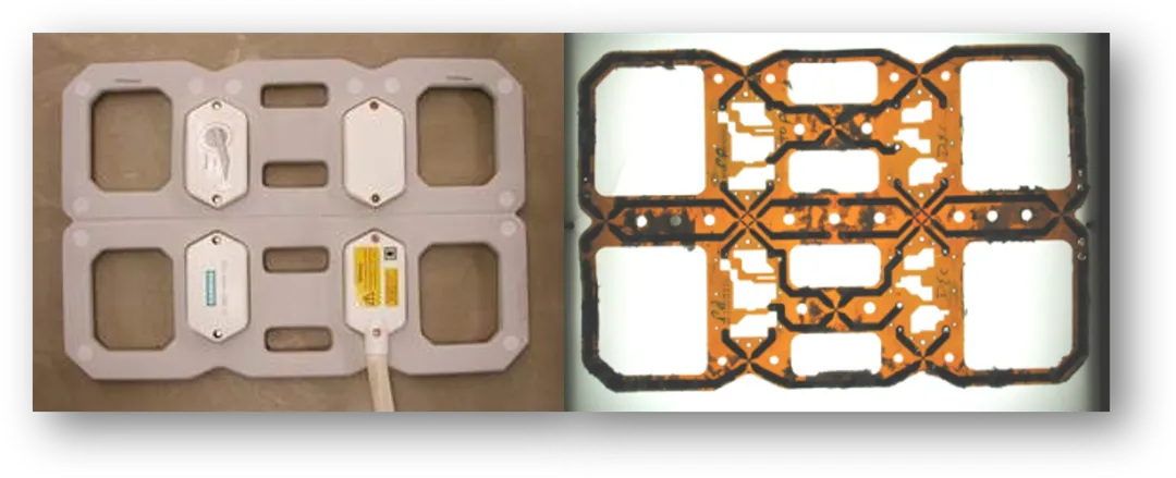

Another common failure applies to what are now called, traditional flexible coils. Flex coils are designed to be draped across (but not wrapped around) a region of interest. Embedded within the flexible areas of the coil is complex circuitry mounted to and connected by flexible copper traces. As you can guess, continued flexing will degrade and damage the flex circuits and is one of the more common points of failure on these types of coils.
Caption: Photo and X-ray image of a traditional smaller flex coil from Siemens Healthineers
Similar to cable failures, flex circuit failures begin as highly intermittent issues that progress into hard failures. Common to flex coil failures are stress fractures and tears in the flexible traces underneath the foam covering. Many times, there are no signs of physical damage to the foam, yet the underlying circuitry has become compromised. That being said, a solid percentage of flex coils present with tears to the foam as well as the underlying circuitry due to improper handling and transportation practices.
What are typical solutions to address failures to traditional flex circuits?
A common approach to repair flex circuit failures is to cut and fold-back the foam covering, bridge/patch the broken flex circuit with copper material, and then reseal the foam. In extreme cases, when there are many compromised areas, the entire flex area needs to be replaced, and the entire coil needs to be re-foamed. Each repair provider has their own unique approach. Degrees of success and repair longevity are based on the materials and techniques employed. Innovatus is confident in its approach, as coil repairs are warranted for 6-months. Innovatus has the ability to perform re-foaming in-house on about 98% of all flex coils, which saves time, money, and provides like-new performance and appearance.

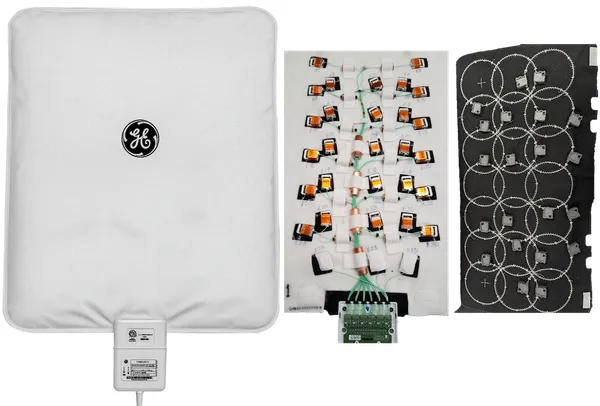

The newest style of flex coil resembles a blanket. The most notable are the GE Air™ coils but other OEMs are updating their designs. These newer designs have eliminated the traditional copper flex circuits, as well as the foam, the most-frequent points of failure. The entire coil is flexible and can be totally wrapped around the anatomy. All of the circuitry is mounted on a flexible, very lightweight, ribbon-like, conductive material, and is embedded within a protective, vinyl-like, cover.
Caption: Various layers of a GE Air coil
Despite the radical technological and material advances within these new coil designs, Air™ coil users have been beginning to experience failures associated with continued flexing and stretching of the internal circuitry. The challenge is that traditional repair methods are no longer applicable to these innovative designs.
Innovatus engineers have been able to develop comprehensive repair solutions to address the challenges of this recent technology. Our repair teams are not limited by any of the recent technology, components, or high-tech flex circuitry within the Air™ coils. As with all of our repair solutions, our in-house engineers develop full schematics, bills of materials, proprietary tools, and test procedures relative to each coil’s unique design. It’s a confident “Yes”, that Innovatus can repair your Air™ coil.
