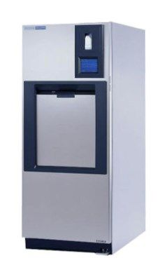

Pre-vac Amsco / Century V116 Steam Sterilizer
Pre-vac Amsco / Century V116 Steam Sterilizers are designed for fast, efficient sterilization of heat and water-resistant materials with the same capabilities as a gravity sterilizer. The V116 pre-vacuum sterilizer is equipped with pre-vac, gravity, flash, express, leak test, and daily air removal test cycles.
The V116 sterilizer provides enough space fit all of your equipment and sterilize with speed and reputable quality in mind.
