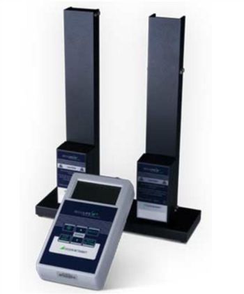

 The SECULIFE IF+ Infusion Pump Analyzer is purpose-built for biomedical engineers who need accurate, reliable testing of intravenous (IV) infusion pumps. Designed to ensure correct pump operation, it can test up to two infusion pumps simultaneously with precise microprocessor-controlled measurements.
Featuring a durable and user-friendly design, the SECULIFE IF+ uses unobstructed plastic fluid paths that are rugged, easy to clean, and safe for repeated use. Interchangeable chambers and cables enhance flexibility, while the system automatically identifies each chamber upon connection. Calibration data is stored electronically within each chamber, ensuring full interchangeability and eliminating manual recalibration.
Lightweight, portable, and tough, the SECULIFE IF+ provides biomedical engineers with a dependable solution for infusion pump testing, calibration, and preventive maintenance in hospitals, laboratories, and clinical engineering environments. (Generated by AI)
[list]          [*] Easy to Use          [*] Easy to Clean          [*] Simultaneous Operation of T wo Chambers          [*] Large Graphics Display with Cursor Selection of Options & Setup of Parameters          [*] Auto Chamber Recognition          [*] 2 Chamber Sizes (3.5 & 35 mL)          [*] Out-of-Sequence Sensing          [*] Battery Display (0 to 100%)          [*] Ranges 0 to 999.9 mL/hr & 0 to 9999 mL/hr          [*] ±1% of Reading Flow A ccuracy          [*] Digital Calibration - No Pots to Turn          [*] Replaceable Tubes          [*] Sealed Level Sensors          [*] Programmable End of Test Audio          [*] Programmable Auto or Manual Test Start          [/list]
