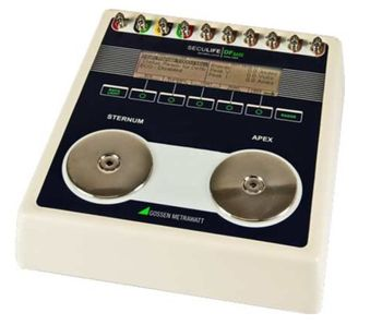

Used for functional testing of external defibrillators.
The SECULIFE DF BASE Defibrillator Analyzer is designed for biomedical engineers who need accurate, reliable, and efficient testing of defibrillators. The device measures delivered energy using a built-in simulated load of 50 ohms, replicating the resistance of the human body for precise results. Users can rapidly view and select ECG signal types and test data, including 12-lead ECG waveforms with arrhythmias and power pulse measurements, directly on the defibrillator display.
With the ability to run up to 50 pre-programmed Auto Sequences, biomedical engineers can streamline routine testing and verification processes. The included PC software makes configuration simple and user-friendly, ensuring consistent and repeatable test results. The SECULIFE DF BASE provides dependable performance for defibrillator testing in hospitals, clinical engineering departments, and biomedical service teams. (Generated by AI)
[list]          [*] Quick selection of the desired ECG signal types and test data          [*] Retrieves information about defibrillation          [*] Monophasic and Biphasic compatible          [*] Test for shock algorithm          [*] Measurement outgoing energy          [*] Fully AED Compatible          [*] Monophasic, biphasic and biphasic pulsed energy measurement          [*] On-screen viewing of Defibrillator Waveform          [*] Cardioversion delay measurement          [*] Capacity 5000 V, 1000 Joule          [*] Charge time measurement          [*] 10 Universal patient lead connectors          [*] Full remote operation via RS232          [*] Memory for 50 individual test sequencies          [/list]
