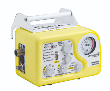

Portable emergency ventilator.
Portable emergency ventilator of small dimensions and light weight suitable for the respiratory treatment of adults, children and new born babies both by invasive intubation and face mask.

  • Volumetric, time cycled, pressure limited with many of ventilatory modes
  • Minute volume: from 1 to 16 lpm
  • Pressure limit: from 0 to 50 cm H2O
  • Tidal volume from 15 to 3000 ml
  • Rate: from 5 to 70 bpm
  • Trigger pressure: from -1 to -5 cm H2O
  • PEEP: settable from 0 to 20 cm H2O
  • Integrated mixing device with possibility to set oxygen mixture at 50% and 100%.
  • Acoustic and visual alarms for: apnea, low battery level, high pressure, low pressure, gas supply failure and power supply failure.
  • Battery autonomy: 6 hours with possibility to join up to 24 hours autonomy by adding an optional battery pack.
