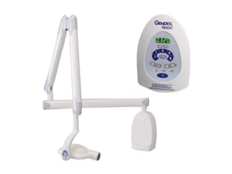

Gendex - 765DC Dental X-Ray
by Gendex
Dental X-Ray System
