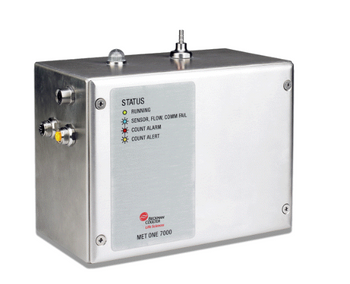

Beckman Coulter - Met One 7000
by Beckman Coulter
Air Cleaner
The MET ONE 7000 provide high accuracy non-viable particle monitoring for cGMP/FDA compliance. Stainless steel wash-down resistant enclosure and VHP tolerant optics protect the instrument while ISO 21501 certified calibration assures accurate continuous monitoring in aseptic and sterile pharmaceutical production environments.
  • Rugged design for cleanrooms with industry leading quality & reliability
  • Stainless VHP, wash-down and chemically tolerant NEMA 4X enclosures
  • Built-in flow sensor for CFR21 data accuracy and reliability
  • Particle size 0.5µm and 5µm sensitivity at 0.1cfm or 1.0cfm flow rates
  • Long life laser diode for guaranteed continuous monitoring
  • Easy to integrate with any facility monitoring system
  • Open architecture design to communicate seamlessly with your system
  • Pulse, Serial Modbus, Ethernet, Wireless and Analog options
Performance
  • ISO 21501-4 unit-to-unit accuracy & reproducibility
Industry Standards
  • ISO 21501-4 , ISO 14644-1:2015, CE, FCC
Light Source
  • Long Life Laser™ Diode
Coincidence Loss
  • 5% at 14,000,000 particles/m³
Sample Volume
  • 10 µm
Throughput
  • 28.32 L per minute
Zero Count
  • ISO 21501-4 & JIS B 9921 (1 count or less in 5 min; 95% UCL)
