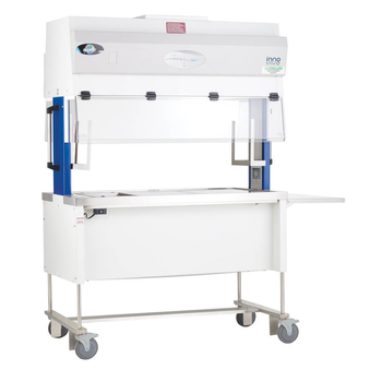

The NU-620M uses an impeller and HEPA filter in both the supply module at the top of the unit as well as in the exhaust module at the bottom to turn the work zone in between into a vertical “piston of air.” The transfer station’s supply impeller at the top of the “piston” draws air down through a prefilter and propels it past a supply HEPA filter and towards the work zone to create a clean air environment. From there, the exhaust impeller at the bottom of the “piston” pulls the downflow air through the slots in the work surface to provide allergen containment. It continues to suck all the air past an exhaust pre-filter before pushing it out an exhaust HEPA filter at the bottom of the transfer station. This “push-pull” airflow passes through a work surface divided by air grills into clean and dirty areas and a work zone configured with the deep wells and feeder holders that the Innovive™ cage changing process requires.
AEROMAX CONTROL SYSTEM
  • The Aeromax control system visualizes airflow plenum pressure through a series of multicolored lights and activates both an audible and visual alarm whenever station performance departs from normal parameters.
CONFIGURED JUST FOR INNOVIVE
  • The Innovive® edition NU-620M is configured specifically for technicians to carry out the Innovive® disposable mouse cage changing process with the greatest ease and efficiency. The placement of the deep well(s), the feeder holders, and the optional water bottle rack are purposefully engineered to fit seamlessly with the user's workflow to create the most streamlined and ergonomic experience possible when working with these disposable cages.
SEGMENTED AIR FLOW ZONES
  • The Innovive® edition’s customization for your workflow does not end with adapting the physical features of the work area. The design of the work area must channel the very airflow dynamics themselves to serve the needs of your cage changing procedure. The work surface is designed with airflow slots that harness the power of the vertical “piston of air” to create clean and dirty cage areas that are separately from each other by an air barrier.
NU-S620-500M WORK SURFACE
  • The 5 ft. (1.5m) nominal width model features a pattern of air slots along the perimeter and across the centerline of the work surface. This pattern outlines
the clean and dirty cage areas around two deep wells that allow for an easy to reach and space saving way to stack mouse cages.
  • CONTROL SYSTEM    AeroMax
  • DOWNFLOW FPM (M/S)    80 FPM (0.38 m/s)
  • PROTECTION    Product
  • WORK ACCESS OPENING(S)    14-inch (356mm)
