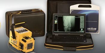

The Enduras Wireless is a complete veterinary digital radiography system that can be used with any functioning x-ray generator, is easy to use, ultra-durable, and sets up in under a minute. With excellent image quality crucial to diagnostic imaging, the Enduras Wireless digital radiography system is your on-the-go solution.
  • Cassette-sized DR panel — will fit conventional bucky tray
  • Available with either a 14" x 17" or 10" x 12" wireless digital detector
  • Auto-sensing digital detector compatible with any properly functioning x-ray generator
  • Exceptional image quality with CsI DR Panel
