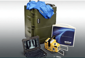

Ultra-durable and entirely battery-powered, the X-Ranger provides superior imaging even under the most demanding field conditions. Designed for Level 1 care, the X-Ranger is a complete portable digital radiography system that combines the powerful TR90BH x-ray generator with a wireless CsI x-ray flat panel detector and ruggedized laptop or tablet all in a compact, military-grade transport case.
  • TR90BH battery-powered x-ray generator
  • 14″ x 17″ wireless cesium digital detector in carbon-fiber housing
  • Ruggedized tablet or laptop loaded with DICOM 3.0 compliant imaging software
  • Custom case options available
  • Total Weight In Mil-Spec Transport Case: 99 lb (45kg)
