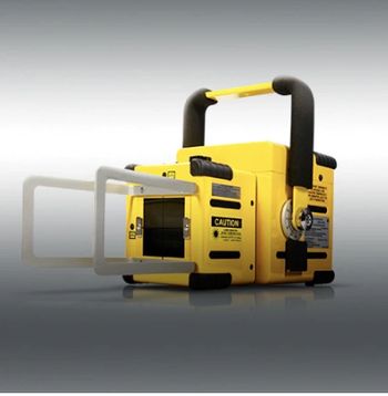

With the TR90BH battery-powered X-ray unit, you will have imaging capabilities regardless of the location. The TR90BH battery-powered X-ray unit is easy to use and quickly programmable for storage of up to 5 exposure techniques. Lightweight, ultra-durable, and powerful with a long-lasting battery life, the TR90BH is your ultimate solution when working in the field regardless of available power.
  • High output, low weight and hundreds of exposures from a single battery charge, packaged in MinXray’s durable designs — the TR90BH battery-powered X-ray unit. Compact but powerful, field-tested and field ready.
  • Long lasting, quick change lithium ion battery
  • Unique High Power Mode — up to 50% increase in output at 82-90 kVDC settings
  • Ideal output and features for use with digital or film imaging systems
  • Backed by industry leading warranty
