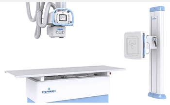

Xtreme can be configured according to your needs: general radiology, trauma, emergency room, orthopedics, pediatrics … Used with cassettes, CR plates or flat panel detector, it consists of a ceiling suspension, a vertical or tilting bucky, and a fixed or mobile lifting table. It exists in manual, servo-controlled and auto-positioning versions. Combination of fixed and portable digital detectors in the same room increases the possibilities of procedures covering routine clinical examinations.
  • With the synchronization mode, the ceiling suspension follows the movements of Bucky (table, vertical Potter) … and vice versa…
  • With autopositioning, each stand is automatically positioned in all axes, whether it is the image receiver or the tube, the collimator blades open to the image format set in the protocol, and the additional filters are set up according to the examination
  • The servo-controlled motorization ensures precise synchronization between the image receptor and the suspension with smooth movements.
  • Change at your fingertips: adjust exam-related settings with the touch-sensitive console and 6.5″ touch screen.
  • The main control buttons are included on the infrared remote control (option to the autopositioning configurations).
  • The large suspension travels allow you to cover a large X-ray area and therefore to take care of patients on a stretcher more easily (compare to a floor mounted system such as a column).
  • Once the stretcher is along the lift table, from the opposite side of the table, you can adjust the height of the floating tray for patient transfers with the optional double pedal.
