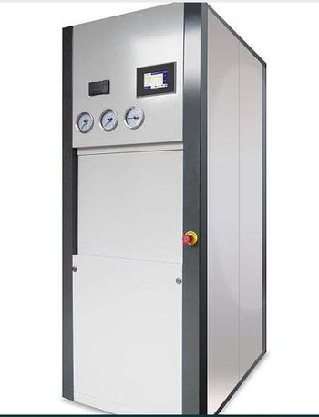

The Laboratory / General Purpose SQUARE range from Astell Scientific is available in three regular capacities of 109, 249 and 430 liters. Each is supplied ready to accept a site steam supply (50 - 80psi). If site steam is not available then an optional steam generator can be added. All units feature Astell's standard fitment color touchscreen controller containing digital temperature and pressure displays, cycle selection, password security, and continuous data archived up to 5,000 cycles.
This laboratory autoclave range is designed with flexibility in mind - the inclusion of a jacketed pressure vessel and vacuum system means each autoclave is capable of sterilizing a wide variety of load types.
  • A fully programmable Color Touch Screen controller
  • ASME standard electropolished stainless steel chamber
  • FDA 21 CFR part 11 software option available
  • Cooling Lock
  • External pressure guage
  • Five password levels to stop lower level users making changes
  • Five pre-programmed cycles and up to 50 available
  • Internal memory for storing up to 5,000 cycles
  • Optimised for low water and power consumption
  • Optional Stainless Steel Panelwork
  • Over Temperature/Over Pressure cut out
  • Safety valve test and emergency stop button
  • Standard Astell safety features
  • Temperature range of 212°F to 280°F (0.2 - 2.4 Bar)
Applications may include the sterilization of:
  • Wrapped and unwrapped hard goods
  • Porous and non-porous hard goods
  • Liquids in unsealed open containers
  • Biohazard waste
  • Animal feed
  • Animal bedding
  • Bowie Dick
  • Leak test
