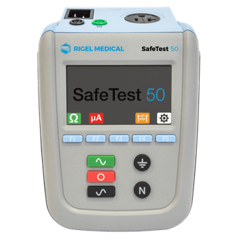

 The Rigel SafeTest 50 is a rugged, dependable, and portable medical safety analyzer designed for high-volume testing of medical and laboratory equipment that does not require patient lead testing. Ideal for biomedical engineers and clinical technicians, it delivers fast, accurate, and compliant electrical safety testing in any environment.
Featuring a large color display and an intuitive, color-coded user interface, the SafeTest 50 allows users to select and perform test routines with just a single key press. This streamlined workflow saves valuable time while maintaining high testing accuracy and consistency.
Despite its compact and lightweight design, the SafeTest 50 supports a comprehensive range of international electrical safety standards, including:
  • Leakage testing: NFPA-99, ES 60601, IEC 62353, IEC 61010
  • Ground bond testing: NFPA-99, IEC 62353, IEC 61010
With full manual control, users can execute only the tests they need and manage power cycles independently, ensuring efficient, precise, and user-controlled safety testing.
The Rigel SafeTest 50 is the ideal solution for hospitals, laboratories, and biomedical service departments seeking a reliable, easy-to-use electrical safety analyzer that combines speed, accuracy, and durability in one compact instrument. (Generated by AI)
Specific to ES 60601:
- Ground leakage
- Chassis leakage
Specific to NFPA-99:
- Ground leakage
- Chassis leakage
- Ground bond testing
Specific to IEC 62353:
- Equipment leakage
- Ground bond testing    Specific to IEC 61010:
- Touch leakage
- Touch voltage
Electrical Safety Tests performed:
- Point-to-point testing
- Line voltage measurement
- Line frequency measurement
- Load current measurement
