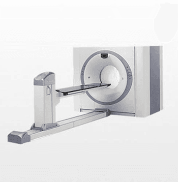

The Siemens Biograph 64 PET/CT is an integrated positron emission tomography/computed tomography (PET/CT) scanner designed to combine metabolic and anatomical imaging in a single system. The Biograph 64 TruePoint platform integrates PET and multi-slice CT technology to support advanced diagnostic imaging applications in oncology, cardiology, and neurology.
This Siemens Biograph 64 TP PET/CT features TruePoint PET detectors, a Straton Z X-ray tube, Biograph PHS patient handling assembly, PET syngo software, image analysis capabilities, DICOM connectivity, network connectivity, and a range of advanced 3D visualization and image-fusion applications.
The listed system includes CARE Dose, CARE Bolus, Extended FOV, Image Fusion, Fusion LM, Fusion Autoreg, Volume Rendering, CAP3D Editor, and 3D SSD capabilities. It also includes 19-inch LCD flat-screen monitors and a CD writer.
The Biograph TruePoint systems are designed to provide registration and fusion of metabolic and anatomical information from PET and CT, with software supporting patient management, scan control, image reconstruction, data management, archival, and image evaluation. (Generated by AI)

SpecificationDetails
ManufacturerSiemens
ModalityPET/CT
ModelBiograph 64 / Biograph 64 TP
System FamilyBiograph TruePoint
Product TypePET/CT Scanner
PET TechnologyTruePoint PET Detectors
PET Detector MaterialLutetium Oxyorthosilicate (LSO)
PET Crystal Size4.0 × 4.0 × 20 mm
PET Transaxial FOV605 mm
PET Axial FOV162 mm; 216 mm with TrueV option
PET Image Planes81; 109 with TrueV option
CT Slices64
X-Ray TubeStraton Z
CT Rotation Speed0.37 sec; 0.33 sec with optional high-speed rotation package
CT Scan FOV50 cm / 70 cm Extended FOV
Patient Weight Capacity204 kg (450 lb)
Patient Port Diameter70 cm
Gantry Height202 cm
Gantry Width239 cm
Gantry Depth156 cm
Gantry WeightApproximately 3,973 kg (8,750 lb)
DICOMDICOM Print and DICOM Send
ConnectivityNetwork Connectivity
Display19-inch LCD flat-screen monitors
SoftwarePET syngo / image analysis
Image ProcessingImage Fusion, Fusion LM, Fusion Autoreg, Volume Rendering, CAP3D Editor
Dose ManagementCARE Dose
Contrast ManagementCARE Bolus
Other FeaturesCD Writer, Extended FOV, 3D SSD, CAP 3D Volume
