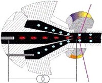

High speed sequential measurements of impedance and light intensity at 12 m/s. The two signals are match in less than 40 µs compare to 170 µs for other manufacturer.
