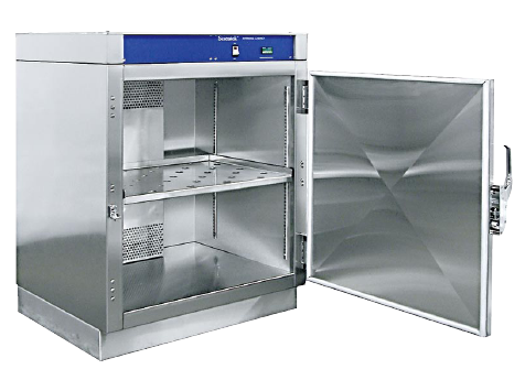

Warming Cabinet
Scientek’s Warming Cabinets provide a constant preset temperature within each chamber for surgical solutions, blankets and other clinical items.

• High quality stainless steel   construction inside and out
• Individual temperature   control per cabinet   (oF or oC)
• Full access within cabinet   load space
• Fan forced hot air   convection over electric   heating element
• Fully insulated cabinet walls   and doors
• Simple construction for   ease of operation and   maintenance
• LED (Light Emitting Diode)   temperature display and   set point
• Full perimeter silicon   gasketed doors
• Positive door closure with   mechanical latches
• Automatic high limit   temperature cutout   and reset
INTERIOR SHELF SURFACE AREA 6.25 sq. ft. - 0.175 sq. M.
INTERIOR CABINET SIZES
WIDTH 25.625 - 651mm
DEPTH 17.56 - 446mm
HEIGHT 28.625 - 727mm
EXTERIOR CABINET SIZES
WIDTH 30 - 762mm
DEPTH 24 - 610mm
HEIGHT 41 - 1041mm
