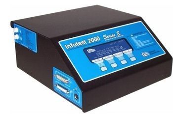

Datrend - Infutest 2000 Series E
by Datrend
The best solution for infusion device inspection.
The Infutest 2000 Series E IV Pump Analyzer delivers superior accuracy—better than ±1% on all infusion pumps, including challenging models like Baxter Colleague and Alaris® Signature. Designed specifically for biomedical engineers and clinical service professionals, the Infutest 2000 is the ideal solution for testing, validating, and maintaining a wide range of infusion devices.
Simultaneously test up to four single-channel IV pumps or four independent channels of a multi-channel pump using the Infutest RSM upgrade module—no factory installation required. (Generated by AI)
  • Unmatched Accuracy: Better than 1% for flow, pressure, and volume measurements—ideal for critical-care pump models
  • Multi-Pump Testing: Evaluate up to 4 IV channels simultaneously for high-efficiency biomedical workflows
  • Versatile Compatibility: Supports single-rate, dual-rate, and PCA (Patient-Controlled Analgesia) infusion devices
  • Intelligent Test Automation: Use manual or autosequence testing via intuitive front-panel keypad and graphical interface
  • Advanced Features:
  • SynchroStart™: Automatically captures startup flow dynamics for pulsatile pumps
  • End-of-Infusion Analysis (EIA): Accurately calculates VTBI when infusion ends
  • Interoperable: Interfaces seamlessly with ES601Plus Safety Analyzer, medTester 5000C, and other automated test platforms (Generated by AI)
