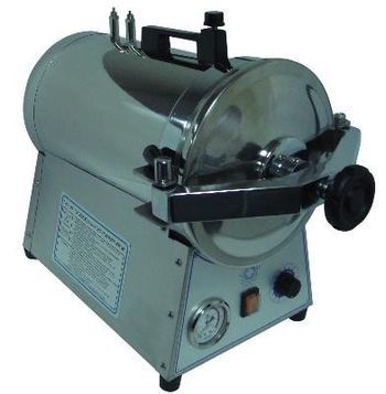

REXMED's RAU-123
MOD. RAU-123, AC 110/230V, Plug type: , Portable N Class Autoclave, HS CODE: 841920, UNCCS CODE: 481412, UMDNS CODE: 13737, GMDN CODE: 36339, Main construction: SS304, Manual mechanical control, Power supply: 1KW immersion type heating element, Program: no, STER timer: 0~60min, Chamber size: 23 x 41cm SS304 no welding, Chamber capacity: 17 liters, Designed temperature: 140°C, Sterilizing temperature: 121/128°C, Designed pressure: 4 kg/cm², Sterilizing pressure: 1.2/1.6 kg/cm², Auto dry: no, Auto add water: Manual, Water reservoir: no, Safety device: thermal cut-off, safety valve, emergency exhaust valve, fuse x 1pc, Vacuum drying: no, Door interlock: yes, Printer: no, W/S: sterilizing box x 1pc, sterilizing tray x 1pc, heating element x 1pc, silicone door seal x 1pc

Autoclave timer
I just wanna ask how will i be able to fix the loosen "button" timer? The round black one holding the timer loosen its grip due to rustiness. And in this case, I have to use thin metal to flip up/raise the timer. Please help me and thank you very much for your favorable response.
