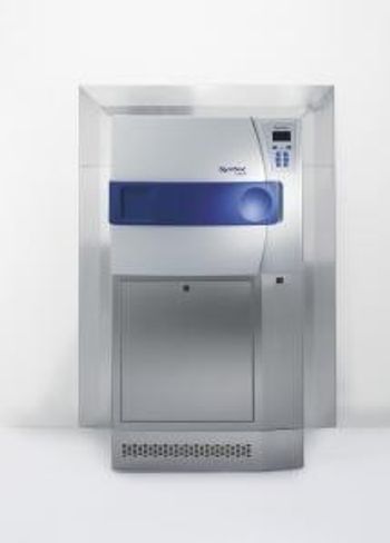

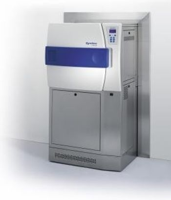

The BSL-3 Autoclave is a specially designed double door autoclave for Biosafety Level III laboratories.The BSL-3 Autoclave is a specially designed double door autoclave for Biosafety Level III laboratories. Outfitted with the most advanced features for hazardous sterilization, this pass through autoclave is installed seamlessly for a gas tight fitting between the critical and non-critical side of your laboratory.
[list]
[*] No heating elements or reservoir for dirty water in the chamber; this facilitates faster cooling as there is no reservoir of hot water that needs to be cooled
[*] Fast heat up times, as steam is always readily available
[*] No need to rely on an in-house steam line
[*] Improved removal of air from the empty chamber via pulsed heating
[*] Accuracy better than ± 0.3 C with empty sterilizer chamber
[*] After cooling, steam is immediately available for the next sterilization run
[/list]
