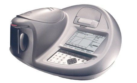

Aware of the critical role laboratories play in the health of the community, BioSystems pursues excellence with regards to quality and reliability without compromise. In this context, BioSystems offers the new streamline designed BTS 350 semi-automatic analyzer with durable mechanics, advance optics and innovative LED powered system. This stylish but robust BTS-350 addresses the needs of any laboratory with special attention to optimize consumption and low maintenance.

[list]        [*] Complete Range of LEDs (340-405,505,535,560,600,670nm)         [*] Durable, humidity Proof Hard Coated Filters + 2 free positions         [*] Black BOX-Optics Sealed Optic Systems-no Filter Wheel         [*] Battery Pack Power Failure (2 hrs)         [*] Monochromatic/Bichromatic Reading         [*] Photometric Rang (0.0 to 3.5A) for all Wavelengths         [*] Sipping volume from 100 µL- 5000 µL         [*] Temp. System from 25° - 40°C (1° C increment) controlled by Peltier         [*] Flow Cuvette 18 µL         [*] Ergonomic designed accessible Pulse for sample loading         [*] Prog Memory up to 150 Techniques         [*] Backlit Graphic Display 320 x 240 pixels with contrast settings         [*] Tactile Membrane Keyboard         [*] USB and serial RS-232 for external Computer Use         [*] Thermal Printer (easy loading)         [*] Patient Result up to 2000 with blank and calibration values can be stored         [*] Levy-Jennings QC chart based on Westgard's rule         [*] Calibration by Factor, single calibrator or calibration curve         [*] Kinetics by Linear Regression         [*] PC Communication        [/list]
Height420 mm
Wavelength Range340 to 670 nm
Length 216 mm
Weight4 kg
Measuring Range0 to 3.5
Width350 mm
