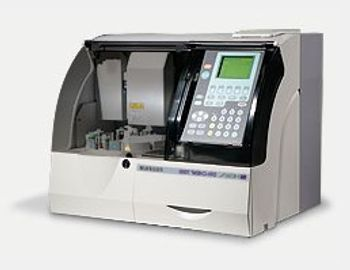

DRI-CHEM 7000 Chemistry Analyzer
Heska's Dri-Chem 7000 Chemistry system is for high volume veterinarian practices. STAT sample capability, automated sample dilution, run 5 individual comprehensive panels in 30 minutes, and 5 individual pre-surgical panels in 16 minutes for all of your in-house chemistry testing needs!

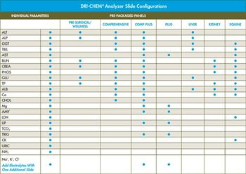

[list]                  [*] Electrolytes and More: Electrolytes on one slide, individual slide options, and pre-packaged panels including the Comprehensive Plus, let you configure the profiles you require.                  [*] Completely Automated Dilution: No guesswork on measuring dilutions or calculating results. The DRI-CHEM® 7000 analyzer provides automated dilution and results calculations on every parameter for samples outside of measurable limits.                  [*] Sampling Flexibility:Choose the 1.5-ml heparinized sample tube or pipette serum or plasma from your regular red-top or green-top tubes into a non-heparinized tube.                  [*] Stack and Run: Load up to 22 tests (20 slides) at one time without jamming, using the convenient stackable slide rack.                  [*] Whole Blood Solution: Heska’s lithium heparin sample tubes save you a step. Go from syringe to centrifuge to analyzer with no pipetting required.                  [/list]
Height17.7 in
Sample Capacity20 Slides
Throughput180 samples/hr (CM)/90 tests per hour (ISE)/190 tests per hour (combined CM/ISE)
Length 16.5 in
Power Requirements100-240 VAC
Weight88.2 lbs
Light SourceHalogen lamp (6V, 10W)
Width21.3 in
