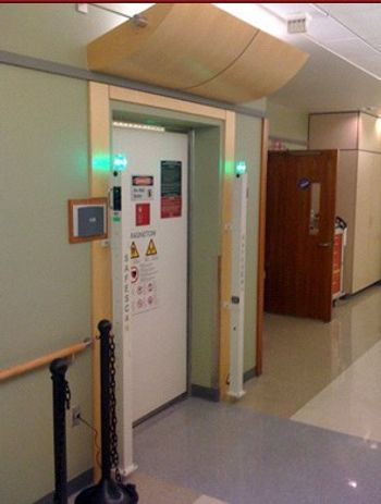

Dual Pillar System
Set at a narrower configuration (26-33 inches), the SAFESCAN INTERCEPT PILLAR ferromagnetic detector has greater sensitivity for smaller ferromagnetic threats. The SAFESCAN INTERCEPT PILLAR system is positioned up to 54 inches apart (or greater when required) to provide doorway protection for larger threats, either entering Zone III or within Zone III protecting the magnet room door (frequently 48 inches wide).    Note: If small ferromagnetic threat objects pass through the aperture closely to the sensors located in each pillar's vertical limb, these can often be detected, even if the pillars are spaced at a wider distance. With ANY ferromagnetic detection ferromagnetic detector sensitivity increases to the cube of the distance - 2x closer to the sensors results in 8x increase sensitivity.    The SAFESCAN INTERCEPT PILLAR ferromagnetic detector system has a fundamental (patented) technological advantage because of the utilization of a non-radiating, passive (DC) magnetic field to improve sensitivity and detection capability. This is especially important for detection of non-premagnetized ferromagnetic objects which have no magnetic moment of their own.
[list]  [*] Establishes the benchmark as the premiere and most cost-effective dual pass-through ferromagnetic detector in the marketplace  [*] Utilizes non-radiating, completely passive DC field to increase sensitivity - proprietary patented feature which does NOT affect imaging quality or patient safety (no magnetic pulses of any kind; no need for shielding)  [*] Sensor array in gradiometer configuration on each pillar, utilizing multiple ISO9001 certified sensors  [*] The use of gradiometers significantly reduces objectionable false alarms  [*] Freestanding or mounted versions, depending on site layout requirements  [*] Unsurpassed flexibility - wide for doorway, or narrow for more sensitive subject screening  [*] 4 sensitivity settings allow accommodation to your particular environment  [*] Variable-volume 2-tone audible alarm, and large LED lights atop each pillar easily visible from all sides  [*] Night-light mode and sensitivity lock for after hours MR Safety protection  [*] Ideally suited for use with our hand-held SAFESCAN® TARGET SCANNER™  [*] Mednovus Quality, Durability, and 3-Year Warranty  [/list]
Aperture   Variable (Recommended 26 inches to 54 inches, greater when required).  Controls   Normal / Night mode rocker switch.  Volume, variable rotary control.  Sensitivity, multi position rotary switch with key lock.  Visual Indicators  Ready, green LED on top of each vertical pillar.  Alarm, flashing red LED on top of each vertical pillar.  Both red and green LED illuminate during pillar alignment.  Audio Indicator  Alarm buzzer ~2.5kHz to ~ 3.8kHz.  Activation  Photoelectric sensor, reflective beam on each pillar.
