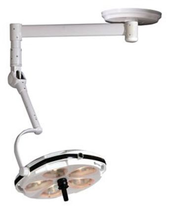

[list]  [*] Optionally Voice or Touchscreen Activation Ready   [*] Optional, Portable High Resolution Sony TV-II Handle Camera System   [*] Advanced Multi-Lamp Optics with Vertically Segmented Reflector Design   (VSRD)   [*] Provides Focusable Control over greater working distances   [*] Retains 90% of Maximum Intensity at any distance   [*] Provides Uniform 30" Depth of Field   [*] Revolutionary Polymer Construction (Featherlight Maneuverability,   Radically Advanced Durability)   [*] Cool Beam Temperature   [*] Glare Reducing, Soft White Light   [*] 23" Single Lighthead   [*] Intensity up to 12,000 footcandles (130,000 lux)   [*] 360 degree movement at all points of rotation   [*] 90 degree downward travel for low angle lighting requirements, 20   degree upward travel for taller surgeons   [*] Bulb life generally 5X competitive systems, protected by Skytron's Sof-start system   [*] Wall mounted Intensity Control  [/list]
Depth of Field30 in
Lighthead Diameter23 in
