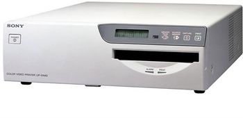

first image captured is split in first quadrant only
Have a Pentax EPK1000 feeding a Sony UP51MDU printer. When capturing images with a scope the first image is split. Subsequent images are fine. Also does not happen when capture button on printer is used. Used 2 different video sources on both RGB and Composite video.
