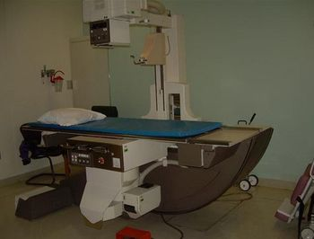

-VicMayal
Wed Feb 25 2015
Siregraph D3 Error 74
HELLO EVERYBODY,
I NEED SUPPORT TO SOLVE THE ERROR 74 ON A SIREGRAPH D3 SYSTEM.
WHEN LOADING KEY IS ACTUATED TO MOVE THE CASSETTE CARRIAGE FROM PARKING POSITION TO LOADING POSITION ERROR 74 APPEARS ON D29.
I CHECKED EEPROM DATA AND EVERYTHING IS O.K, REPLACED THE SEARCH RUN SWITCH (S105), ADJUSTED THE BASIC POSITION OF S105, REPLACED D32.
LED V4 ON D9 BOARD IS ALWAYS OFF (IT DOES NOT LIT WHEN I PRESS THE LOADING KEY).
COULD ANYBODY HELP ME TO SOLVE THIS PROBLEM? YOUR HELP WILL BE HIGHLY APPRECIATED.
THANKS IN ADVANCE.
