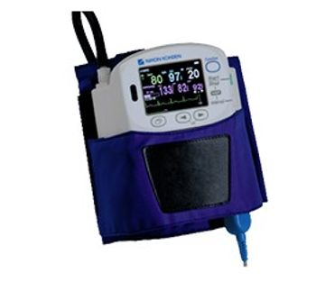

Nihon Kohden - NTX ZM-540/541P
by Nihon Kohden
ECG, Respiration, NIBP, SpO2
Allows for monitoring of up to eight vectors of ECG, respiration, continuous SpO2 and NIBP at the Central Monitor. NTX is designed to provide hospitals with more flexible monitoring on higher-acuity patients. Ergonomically designed to provide patient comfort and mobility, it bridges the gap between a traditional bedside monitor and an ambulatory transmitter.                     The NTX allows hospitals to safely monitor higher-acuity patients while maintaining the flexibility, comfort and mobility associated with the ambulatory patient. Integrated 2.2" color screen displays continuous real-time waveform and vital signs, and provides data review with 10 minutes of full disclosure waveforms and 10 minutes of vital signs data. The display also indicates lead status, battery status and pulse strength. The NTX transmitter operates in the protected WMTS frequency band and provides economical operation through the use of three alkaline "AA" batteries.
