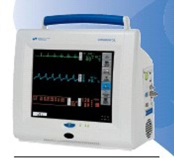

I have an Ultraview SL, model #91369 with an issue with the pushbutton on/off switch. The monitor came into the shop with a wo stating it could not be turned off. I replaced the on/off switch and it's still not working properly.
It powers on when the AC plugged in, but you cannot shut it off. When you unplug the monitor, it will continue to run off DC power and you can turn it off using the pushbutton on the front of the unit, but cannot turn it on using the button. It only seems to turn on when  it is plugged in, and only able to powered down when unplugged.
Anybody have any suggestions? I'm at a standstill with this thing. Thanks in advance.
