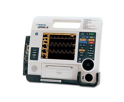

The LIFEPAK 12 Defibrillator/Monitor is a multi-parameter device that combines semi-automated and manual defibrillation with capnography, external pacing, 12-lead electrocardiography and other monitoring functions. Its platform is upgradeable, allowing customers to add new parameters as their needs change and as new features are introduced.
