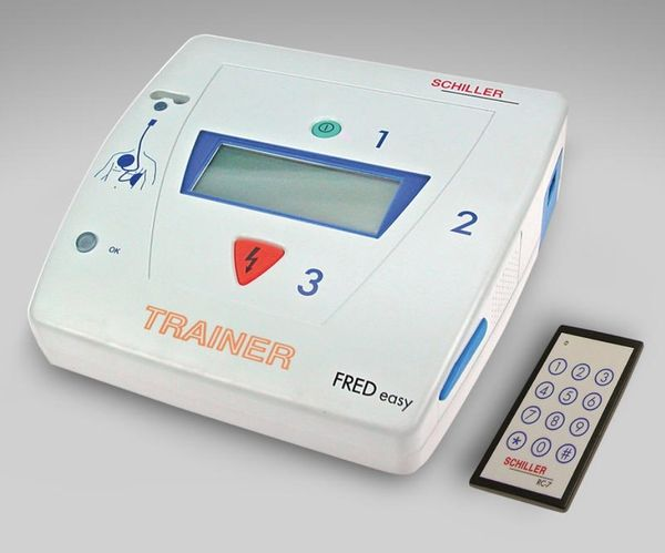

Hi engineers, is it true that this AED does not use charger for the battery? How it can long last?

The device is normally powered by a disposable lithium battery. As an alternative, a rechargeable NiCd battery can be used (see section 4.3 "NiCd Batteries").
Tue Oct 29 2019Reply from selvit
lithium battery capacity - 180 shocks at maximum energy or - 6.5 hours of monitoring (alternately 30 minutes ON and 30 minutes OFF) or - 5 years standby operation.
capacity of the rechargeable NiCd battery - 45 shocks at maximum energy or - 80 minutes of monitoring
