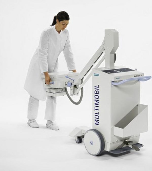

siemens multimobil
red led on thermometer symbol siemens multimobil 5c

Your detector is probably out of tolerance for the heat range. I would start by verifying your connections and the power supplies.

usually coming the thermal sensor on the x-ray tube. maybe bad sensor, bad connection, bad wiring. Good luck.  - Wayne
