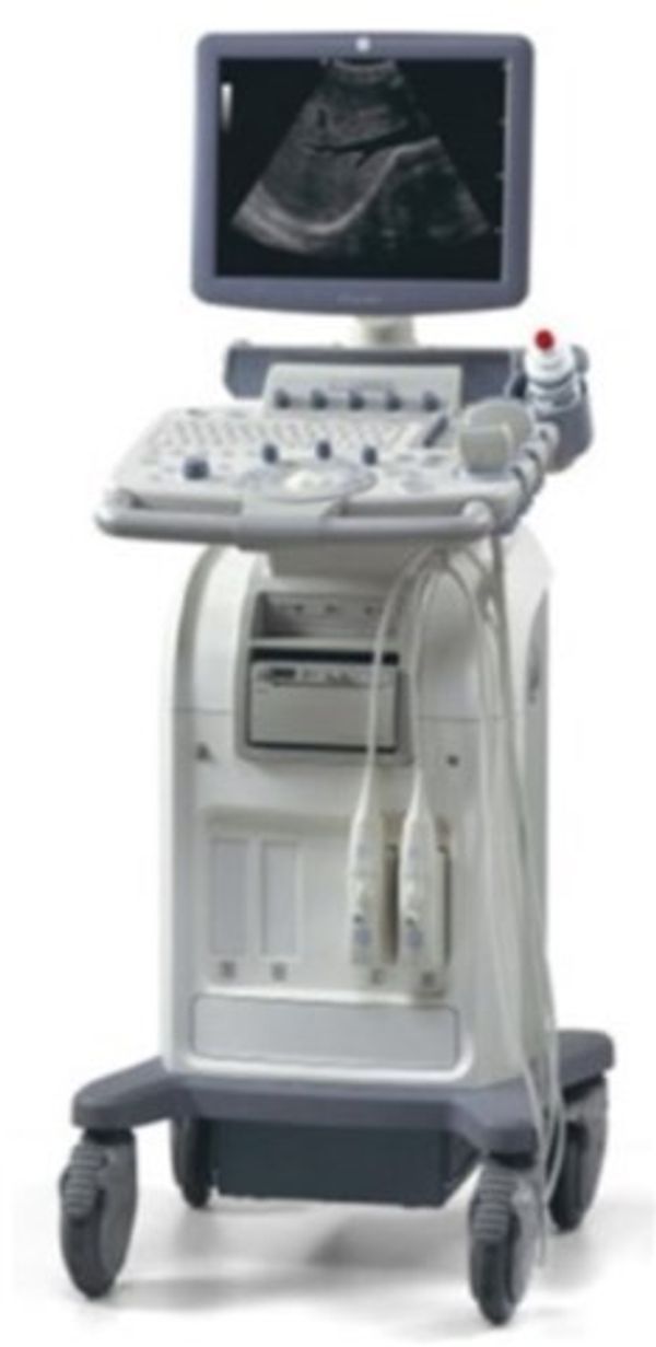

GE LOGIQ C3
I had a faulty HDD which I replaced.Istalled WINXP Professional but not from the yellow cd that comes with C3.Installed Application from yellow C3 cd.,I entered the license key and serial numeber etc.. Everything seems to be working.BUT every time I boot up it asks me for serial number again with the message there is no serial number in the system locate and input it.Where can I change this or what is causing it- Thank you.
Mon Dec 04 2017Reply from MedWrenchManager
Mon Dec 04 2017Reply from SFT
Might want to try it with the disks it came with.
Scott Trefny
Avante Ultrasound 1-800-958-9986
Tue Dec 05 2017Reply from Jim Carr
Jim Carr
The System or Base software disk has other software on it, in addition to Windows. You need to load software using the GE System disk.
