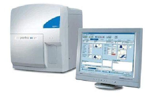

analyzer down
WHAT IS TRANSFER SENSOR TIMEOUT

Liquid sensor could be bad. check also TP48 must be 4.5V+/-.3 if off adjust pot R286.
