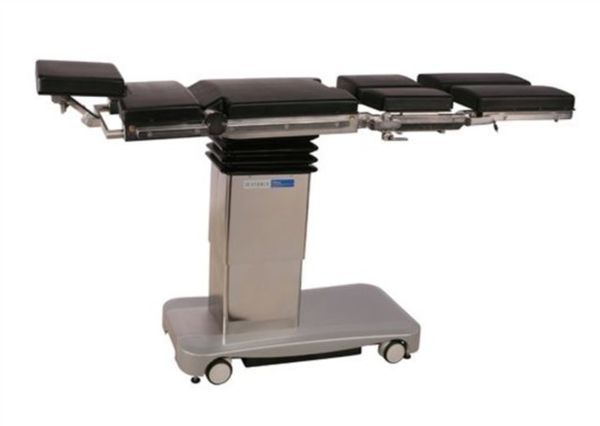

Does any one have a copy of: Steris - Himax Surgical Table service manual

There is no movement from the Steris - Himax Surgical Table when operated from the hand control.
The battery and mains supplies are fine.
When "override" is selected the hand control remain operative and there is no movement when the  "override" controls are used.
The only activity that occurs when  "override"is selected is that the 2 valve motors spin for a short while.
The oil reservoir is well above the minimum mark (about 3/4 full).
Please help if you can.
