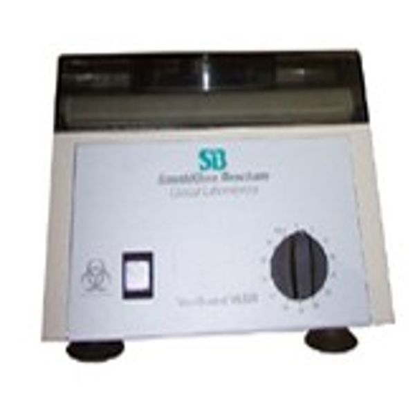

What is recommended for cleaning the inside of this equipment? Need for joint commission standards.
   RE: Centrifuge Report Post
Thu Feb 22 2018Reply from Bob S
Clean bowl area periodically. Remove aluminum shields, unscrew black and white knob counterclockwise, and carefully lift the rotor off the motor shaft. Wipe the interior area of the bowl with a cloth dampened with a suitable disinfectant.
Clean rotor with a solution of sodium hypochlorite in concentrations (of sodium hypochlorite) not to exceed 5%. Rinse with warm water then dry rotor. CAUTION: DO NOT AUTOCLAVE ROTOR.
Check rotor periodically for structural integrity. REPLACE ROTOR IF WORN OR CRACKS ARE VISIBLE. Replace with V7000 aluminum rotor only.
